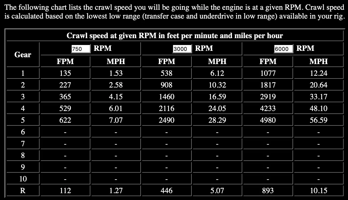

Specs​
  • 1997 TJ SE
  • PR4 "Flame Red" Exterior
  • K5 Seat Style and T6 "Saddle Tan" Interior

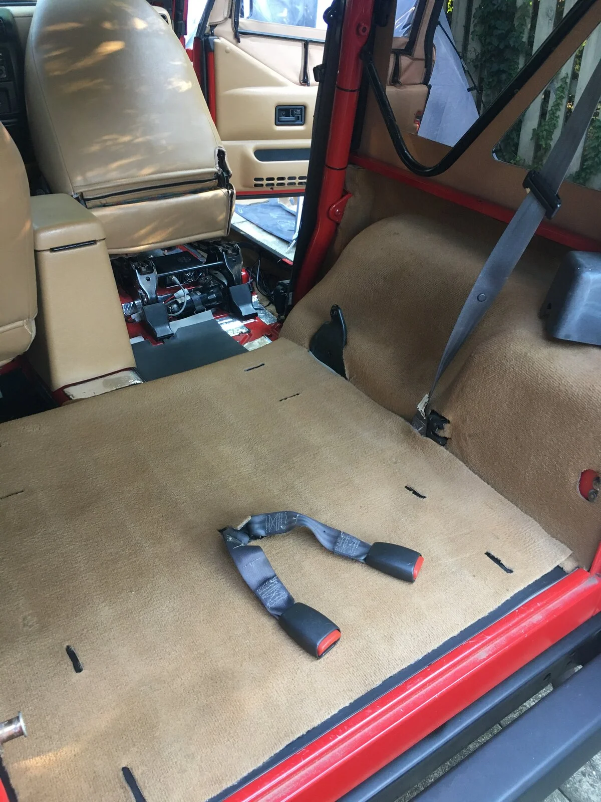

    • Carpet: ACC says 4640 (dark saddle) and 9777 (medium beige) were original. 7140 (medium saddle) matched better.
    • Plastic: SEM 15033 "Saddle Tan" is not a match for T6. T6 "mix code" is 4976, but SEM 15173 is very close.
  • 2.5L I-4 Power Tech:
    • 120hp @5400
    • 140 ft-lbs @3500
  • AX-5 Manual Trans:
    • 21-spline output; 14-spline input
    • 1st: 3.93, 2nd: 2.33, 3rd: 1.45
    • 4th: 1.00, 5th: 0.85, Rev: 4.74
  • NP231J Transfer Case
    • 27-spline output; 23-spline input
    • Hi: 1, Lo: 2.72
    • Torque Capacity: 1,885 ft-lbs

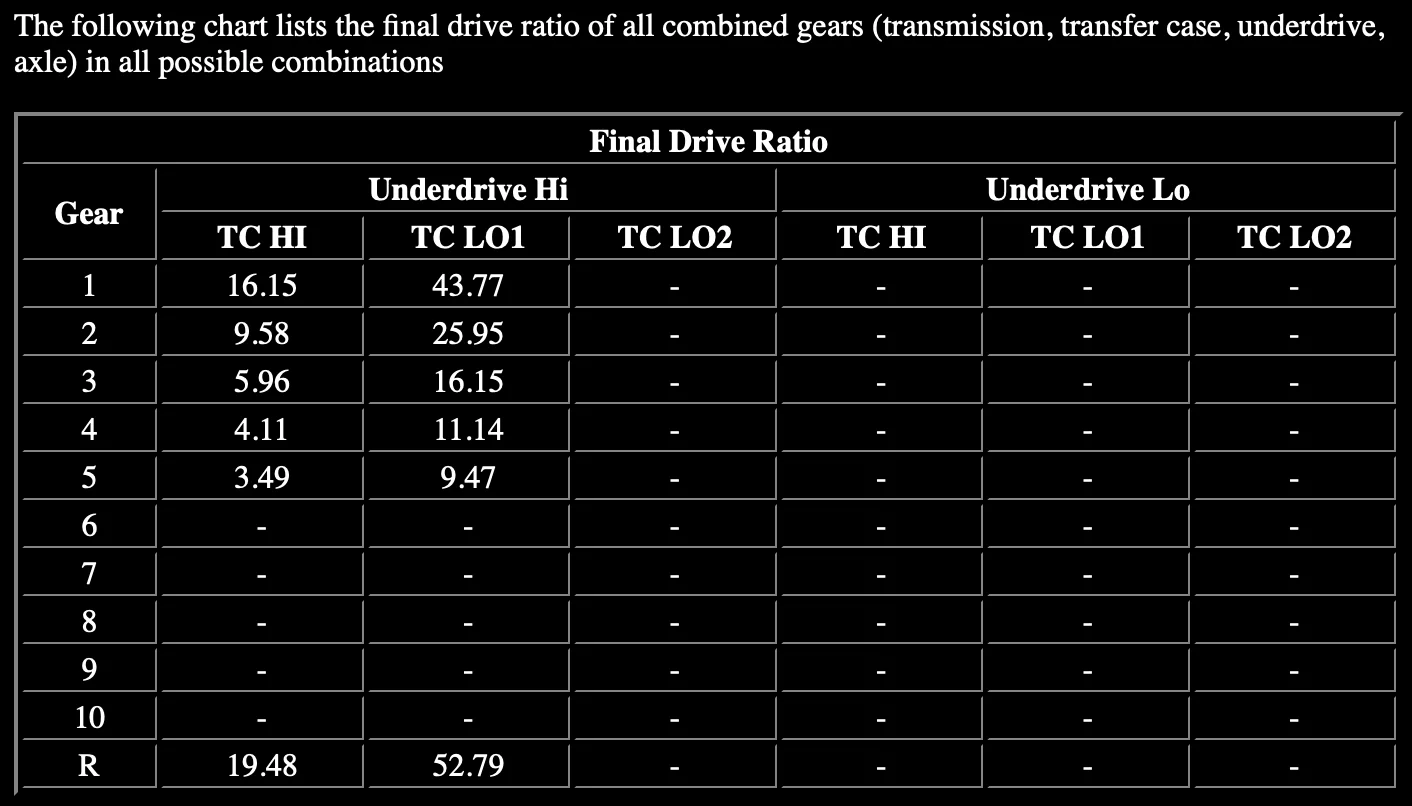

  • 4.11 Rear Axle Ratio
  • 14.8 Total "Crawl" Ratio
    • (Transmission 1st Gear x Transfer Case x Axle-Gear)

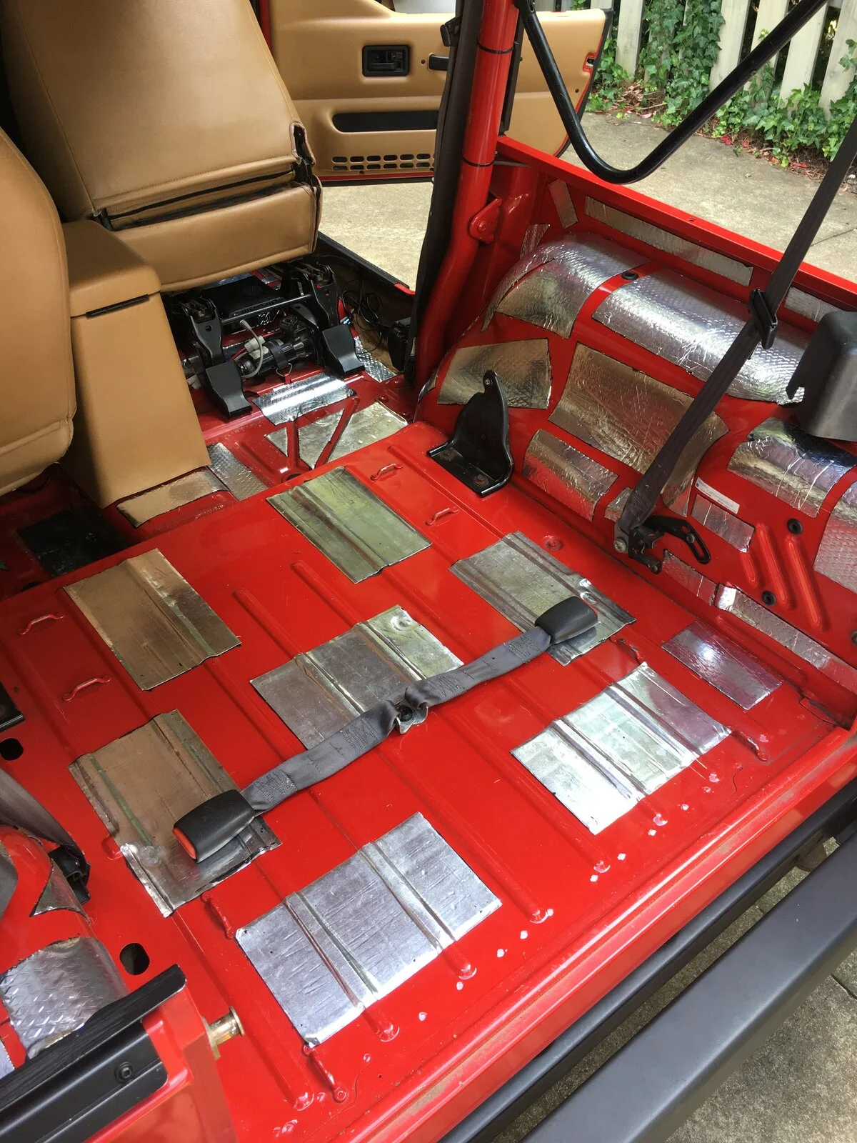

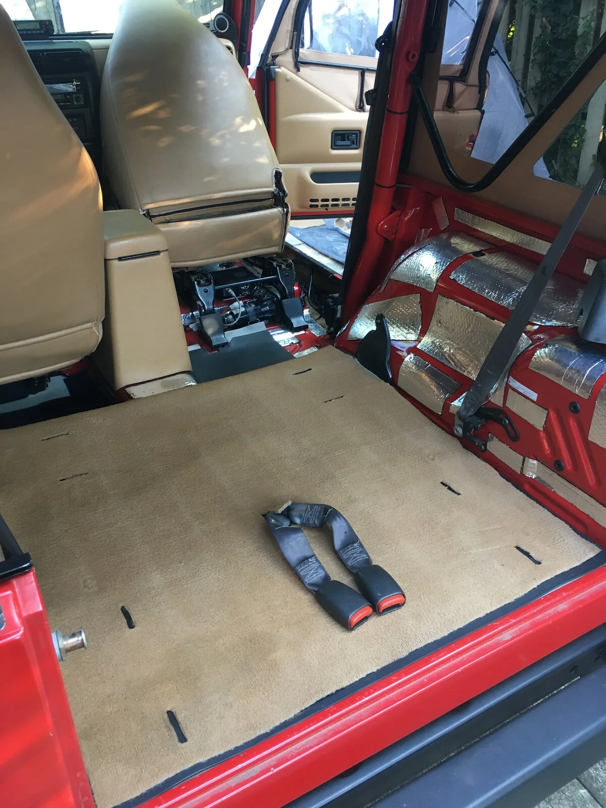

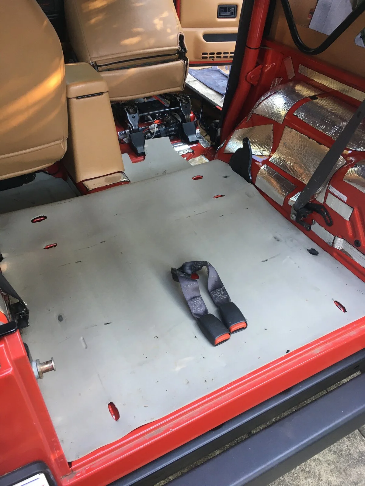

Sound Deadening:

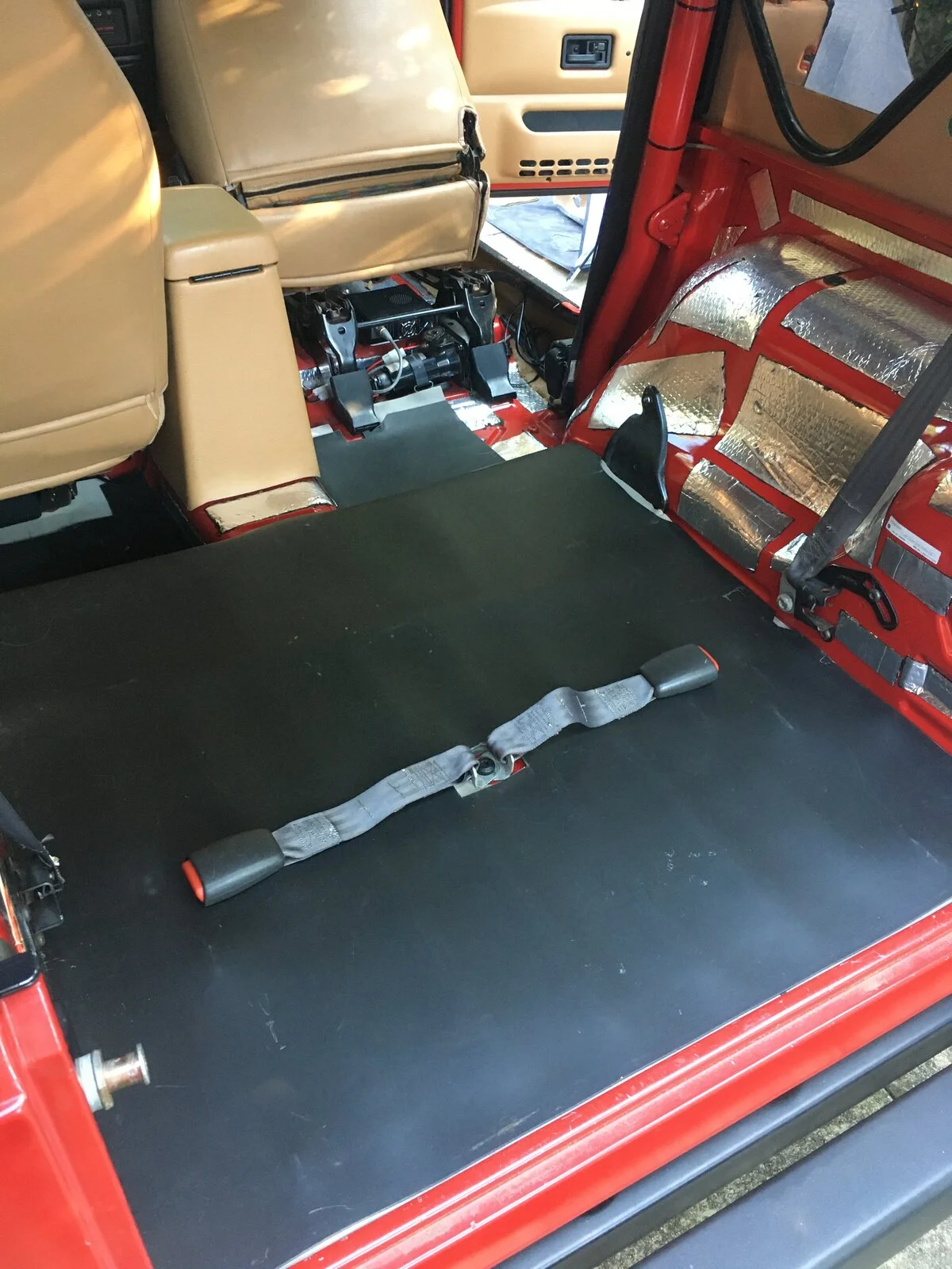

  • Noico 80 mil butyl mat is popular on the forum. Diminishing returns after 50% coverage.
  • Mass-loaded vinyl goes over Noico for better results. Should be separated from sheetmetal by foam (see pics).
  • Hood Liner can help with engine noise.
    • See here about options.
    • MLV in engine bay is discussed here.

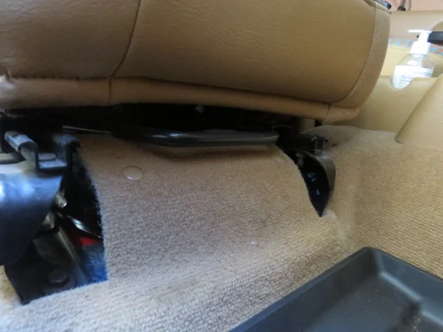

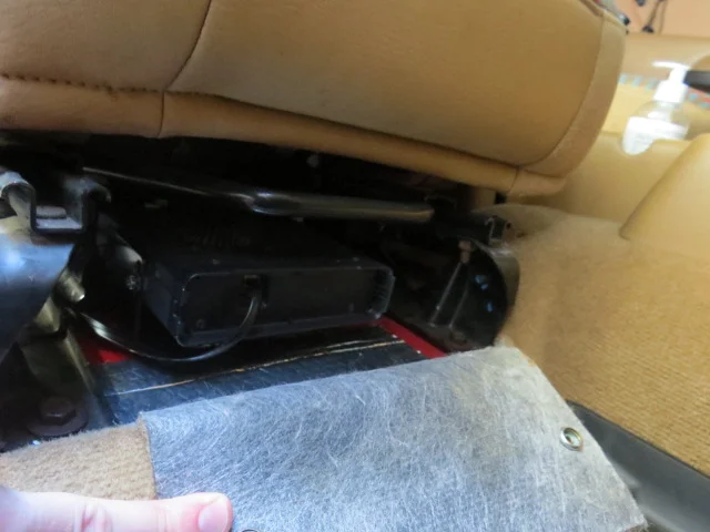

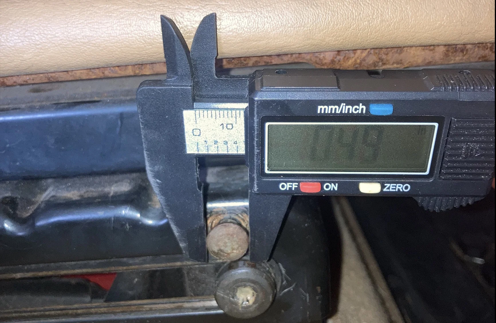

Seat Rattle Fix
  • Passenger seat was rattling. Asked about it here and initially tried this approach.
  • Looked into "Stable Seat" bushing, but they are no longer being sold.
  • Considered this or this DIY approach, then found this product with good reviews.
  • Learned here and here that the product doesn't work on all 97 seats.
  • Started this thread to determine whether I have a 'quirky' 97. Seemed not.

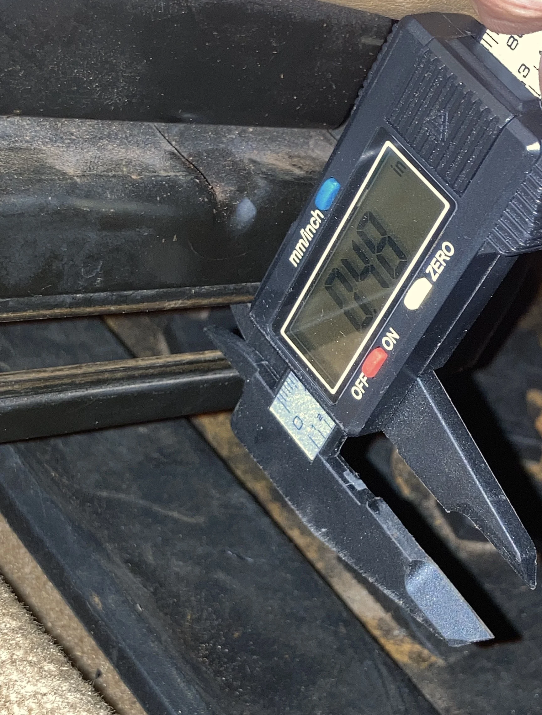

  • Bought the product and installed. Learned that I had other 'quirks', which I posted about here.
  • Learned more recently that Summit now makes a set of bushings. Have not tried them.

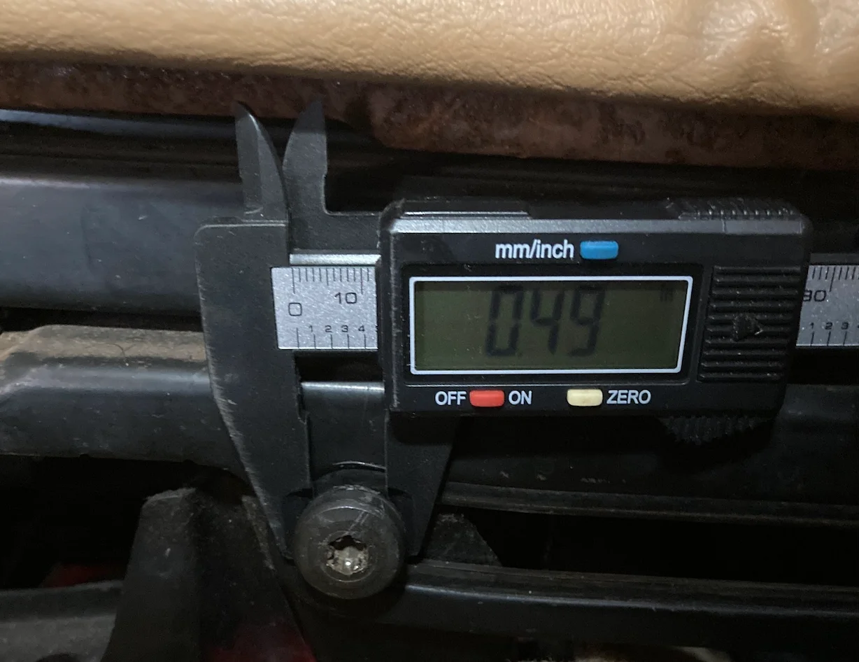

  • Here is what worked for my 97:
    • Rear Bolt​
      Channel / Groove​
      Front Button​
      Front Bushing​
      The bolt on this 97 is a T40, like other models. The head is 0.75". But the shank is thicker (0.5") than on other models, so a flanged bushing isn't needed. Still takes a nylon washer.
      The groove on this 97 is 0.5" tall, like other models. Some 97s have a shorter groove, which is why some aftermarket kits don't fit.
      The 'button' for the front bushing is 0.5" wide at the flange, and 0.25" wide at the shank, and 0.25" deep. Aftermarket spacer had to be trimmed down in length.
      Aftermarket bushing was 0.5" ID and 0.75" OD. Didn't make firm contact, and the seat still rattled. Replaced with a nylon bushing of 0.535" ID, 0.865" OD, and 0.25" L.

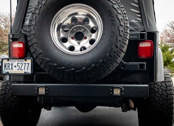

Did you complete the install of the aux reverse lights in the stock bumper?
How did you wire them and which lights did you use?
Nope, I’ve been picky about the exact lights I wanted to get. They should arrive soon. I wanted to stick with an original halogen look. Found some rectangular fog lights off an XJ. Will mount on back bumper.
Haven’t done the wiring yet but plan on posting that here when I do. You doing a similar job right now?
Edit: Oh yea from this thread. No, no progress yet but I hope to pick up on it soon. I will be doing a fairly simple wiring set up, just with a toggle switch. I don’t think I want them coming on every time I go into reverse.
Edit: Ohyea from this thread. No, no progress yet but I hope to pick up on it soon. I will be doing a fairly simple wiring set up, just with a toggle switch. I don’t think I want them coming on every time I go into reverse.

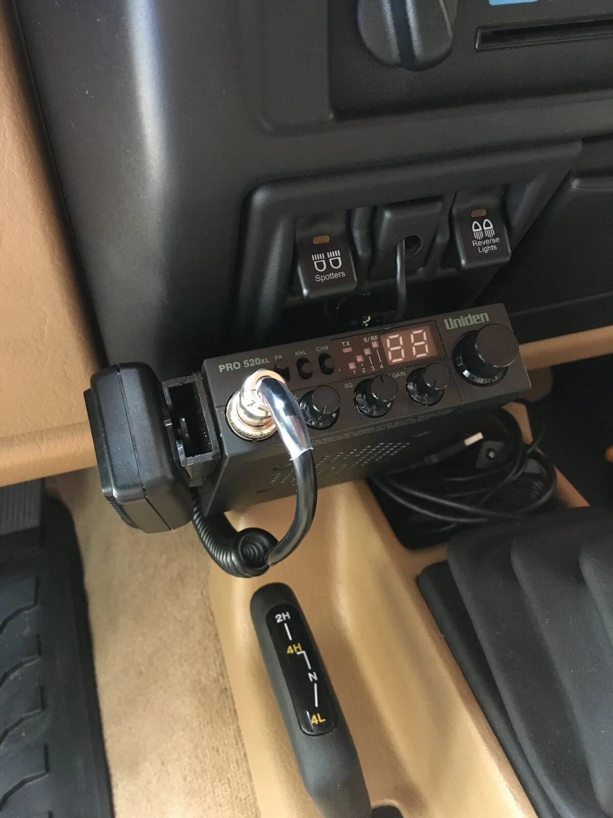

I just finished the DIY switch panel using two OE cig lighter/switch banks, so I have six available since I am not using the rear wiper or defroster grid.
I was set on using the GC switches, but now am exploring the NiLite illuminated switches.
Doing the front aux driving lights this weekend (Hella 500FF).
Night and day.. literally. Wired them to the Auxbeam 8 gang switch panel. Ran the wire down from the switch controller mounted in the engine bay, through the passenger side frame rail and out to a waterproof quick disconnect at the rear bumper.
Reactions: SSTJ
I keep my build info on my local drive and don't update here too often. But remembering that you were doing the reverse light mod at some point, I figured I would post it here for your reference...
